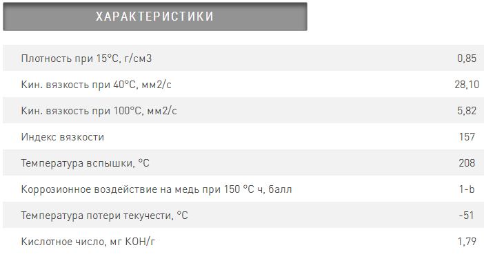

ZIC ATF Multi LF (Dexron VI, Mercon LV, SP-IV)
Оф.страница продукта http://zicoil.ru/products/transmissionn ... ti-lf.html
СООТВЕТСТВУЕТ
Aisin Warner AW-1
DSIH 6p805 (Geely, Ssangyoun, Mahindra)
Ford Mercon LV
GM Dexron VI
Honda DW-1
Hyundai/KIA ATF SP-IV, SPH-IV, SP-IV RR, NWS-9638
Mazda ATF-FZ
Mitsubishi ATF-J3, ATF-PA, SP-IV
Nissan Matic Fluid S/W
Toyota WS (JWS 3324)
Audi/VW G 052 540, G 055 005, G 055 162
BMW 83 22 0 142 516
MB 236.12, 236.14, 236.15, 236.41
Volvo 6 speed MY 2011-2013 (P/N 31256774 или 31256675)
ZF 6 Speed (S671 090 255)
132665 = ZIC ATF Multi LF 1L
162665 = ZIC ATF Multi LF 4L
202665 = ZIC ATF Multi LF 200L
