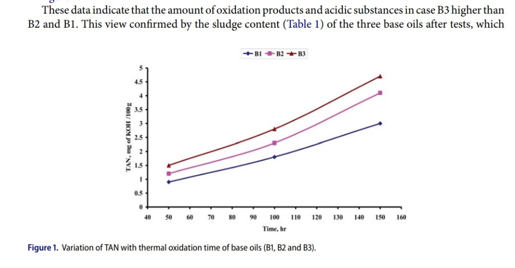

Oxidation stability of lubricating base oils
A.Y. El-Naggara,b, R. A. El-Adlya,b, T. A. Altalhia, A. Alhadhramia, F. Modatherc
, M. A. Ebiadb, and A. Salemb a hemistry department, Science Faculty, Taif University, Kingdom of Saudi Arabia.;
Egyptian Petroleum Research Institute, Nasr City, Cairo, Egypt.; c
Faculty of Science, Al-Azher University, Assuit branch, Egypt.
Ближневосточные товарищи пытали три минеральных масла разной KV100 с почти одинаковым индексом вязкости
Oxidation characteristic of base oils under investigation was carried out according to modified ASTM D943. The tested samples were oxidized at 150°C using copper coil as catalyst and flow rate 5 liter per hours for 50, 100 and 150 hours. After testing, the density, viscosities at 400C and 100°C, total acid number (TAN) and flash point of the tested oil samples were determined using ASTM methods D 1480, D 445, D 664 and D 92, respectively. The rate of oxidation was measured by the increase in total acid number and viscosity
B1 -  7 cSt KV100, VI  = 93<br />B2 - 11 cSt KV100, VI = 94 <br />B3 - 11 cSt KV100, VI = 95
TAN Base OIL.jpg (46.25 КБ) 8995 просмотров
e OIL.jpg[/attachment]
Как то вдруг и совсем неожиданно оказалось что
Oxidized base oil designated B3 is characterized by the having high viscosity, carbon residue, sludge content, flash point and total acid number, while base oil B2 has medium values of these characteristics, but base oil B1 is characterized by having high evaporation loss and low values of total acid number. The results obtained from determining the total acid number indicates that the thermal stability of base oils decrease with increase the heavy ends. In general, total acid number increased with increasing oxidation time.
Heavy oil has the lowest percentages of paraffinic hydrocarbons compared with the other light and middle lubricating oils which decrease with increasing interval times of oxidation
Т.е почему то более жидкая по KV100 база имеет большую анти окислительную способность.. :D :D Привет поклонникам малого NOACK и высокой FP из Египта и Саудовской Аравии :)

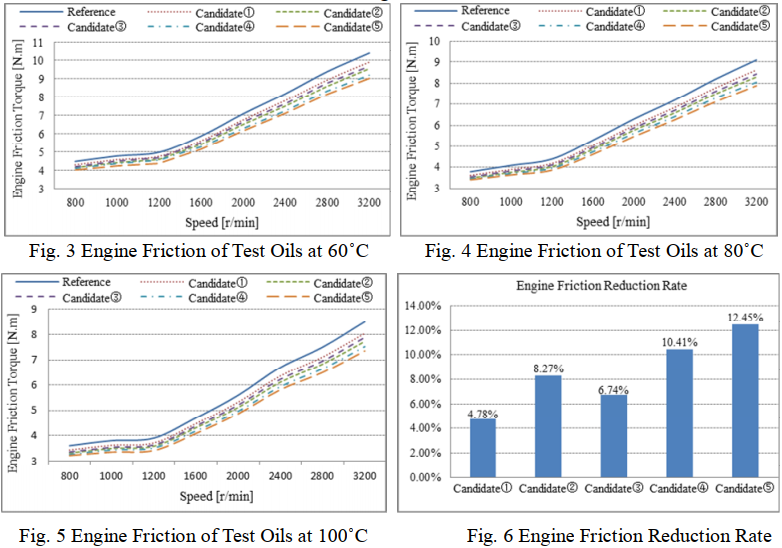

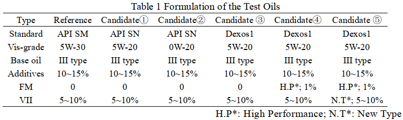

Экспериментальное исследование влияния моторного масла на трение и экономию топлива
Experimental Research on the Impact of Lubricating Oils on Engine Friction and Vehicle Fuel Economy
Выжимка в виде графиков
Особое внимание на графики Fig 6 и 10
График 10 - экономия топлива супернового dexos1 5w-20 составила 2,33% по сравнению с референсным 5-30 A5/B5
Если прикинуть, что при расходе 6 литров на сотню на A5/B5 при переходе на 5-20 вы получите экономию 0,14 л на сотню и расход 5,86
Как вообще такую цифру можно заметить замеряя просто от горловины или по лампочке в обычных условиях ? Это я про любителей петь песни про экономию в 1-2 литра

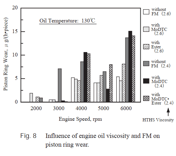

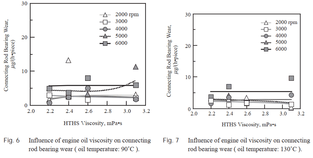

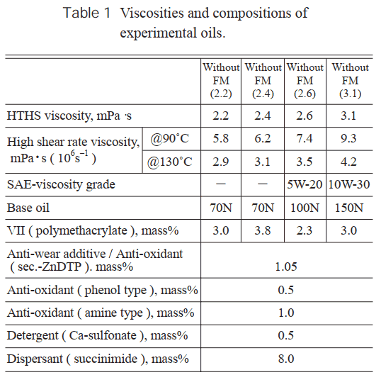

Каждый видит что хочет, но вроде как прослеживается снижение износа при температурах 130 град при росте HTHS
Любимые картинки кое-где и там их трактуют наоборот, смотрите мол как на 0w-20 все замечательно :D
Влияние HTHS на износ
Low friction gasoline engine oil effect of lower viscosity and friction modifier
Износ поршневых колец при температурах 90 и 130 град

Износ шатунных влкадышей при температурах 90 и 130 град

Gubkin писал(а): 27 сен 2018, 17:17 Если прикинуть, что при расходе 6 литров на сотню на A5/B5 при переходе на 5-20 вы получите экономию 0,14 л на сотню и расход 5,86
ИМХО, но мне кажется все двинулись на этой Fuel Economy....Лейте SAE30 и не парьтесь....
Gubkin писал(а): 27 сен 2018, 17:17 Как вообще такую цифру можно заметить замеряя просто от горловины или по лампочке в обычных условиях ?
Никак, если на БК нет счетчика топлива, никак точно не замерить расход - все эти заправки до полного, в реале полная туфта, расход по чекам может спокойно отличатся на 3 - 5 литров на каждую заправку по сравнению с БК..

Судя по этой картинке
что то и от эстеров, и от MoDTC нет особенного толка на высоких оборотах..
Т.е получается зря стритсракеры на своих корчах льют себе всякие гамногоночные масла с конской дозой молибдена и эстеров ...
